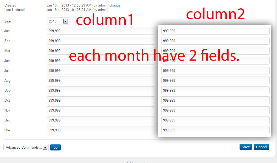

Hi guys,
There are years and monthly fields on the section.
Each month have 2 fields information.
1) Is it possible to build a section like this? (please see the attachment image)
2) In my front page. How can I display the full month information when choose a year?
It look like
When I choose year.
The page will display all 12 monthes information.
Each month have 2 field information.
I use mutli-section to biuld the pages. It seems not fit the need.
Jac
-Jax H.
2-columns.jpg 99K

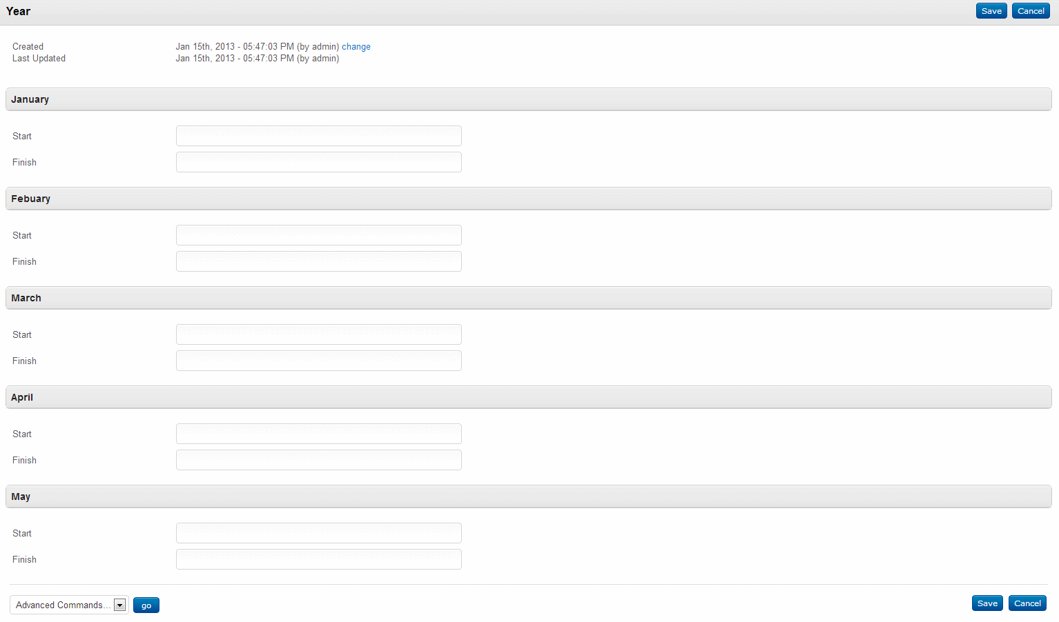

Hi Jac,
I just to confirm what you're after; so each record can have multiple years of data. For example, one record might have data for 2012, 2011, 2010, etc, and not just for one year?
Currently CMS Builder doesn't support having two fields side by side. You would have to have to a have them in a row. I've attached a screenshot of a layout you could try.
