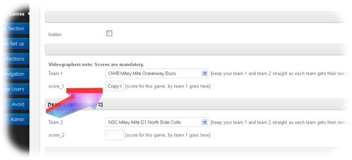

FYI. I just installed a fresh CMSB site, with ver 2.17 and save-and-copy 1.03. It started erroring so I swapped in ver 1.04 of new save-and-copy (and changed out the lines of code in the default menu files according to readme.txt). Error still occurs. What is happening is the text "Copy of..." that normally appears in the title field is showing up in a lower field (in this case, called "score") and the page errors when trying to view publicly. If the code dropped in to the score field is deleted the record views fine. I've attached a screenshot.

Are you able to upgrade to 2.51?  That would be the simplest solution.
The plugin is configured to add "Copy Of " to the beginning of the first text field.  So if you didn't want that added to score_1 you could drag another field to the top or just add another text field at the top.

Aha! Ok, I'll try that.
Thanks.
By Codee - March 5, 2013
Sorry I didn't get back and post here sooner...solution worked fine. Thanks!
