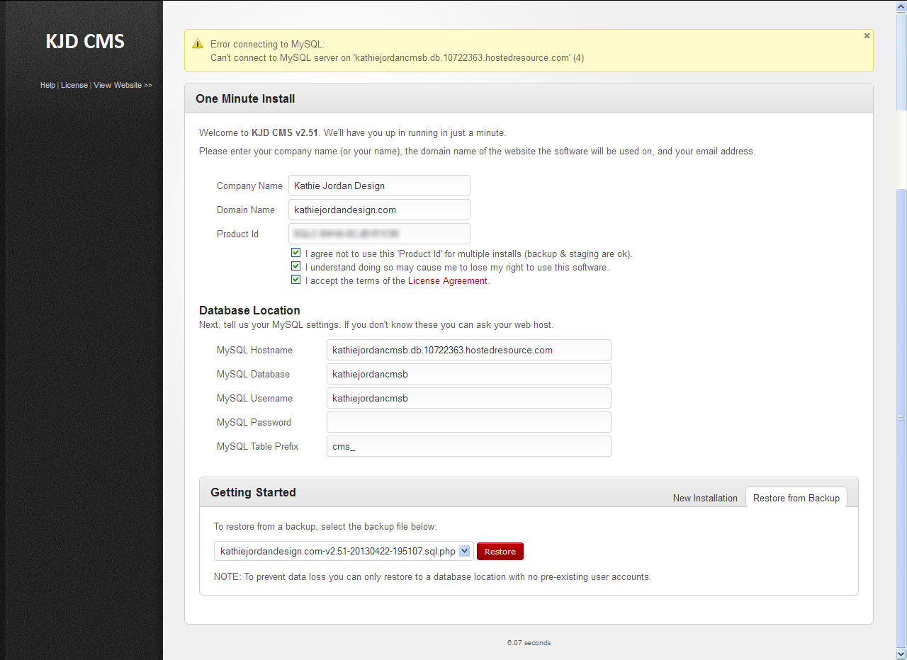

Hi, Dave.
I uploaded all the files from the previous server, then ran the /cmsAdmin/admin.php file. I added the product ID number, and the database details were already there when I viewed that page, selected "Restore from Backup" and the relevant file, but when I clicked the "Restore" button, I got an error message at the top of the page (see attached).
Am I doing something wrong? Do I need to create a new database on the new server?
Nigel Gordijk
kjd-cms.jpg 174K
By CommonSenseDesign - April 23, 2013 - edited: April 23, 2013
Thanks - all working now!
