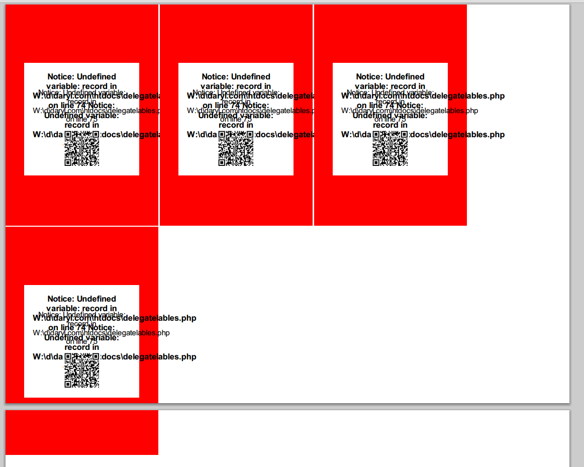

By Toledoh - May 27, 2013
Actually - it doesn't... it's better, but I can't get rid of all margins;
    $GLOBALS['CREATEPDF_CUSTOM_SWITCHES'] = '--orientation portrait --margin-top 0 --margin-left 0 --margin-right 0 --margin-bottom 0';
    createPDF_fromOutput('inline', 'example.pdf');
File attached, and can be viewed here: http://111.118.173.162/~pmafresh/v3/delegateLables.php
delegatelables.php 3K
By Daryl - May 27, 2013 - edited: May 27, 2013
Hi Tim,
I think the problem is in your CSS formating. Try to make the body's margin to 0 : body { margin: 0;}
Also on your attached file "delegatelables.php", you missed the "--margin-top 0" .
Check out the attached file.
Hope this helps!
Daryl
Daryl Maximo
Nope - didn't work... but I'm a bit rushed at the moment and may make a silly mistake.  I'll get back to you.  Thanks for your help!
