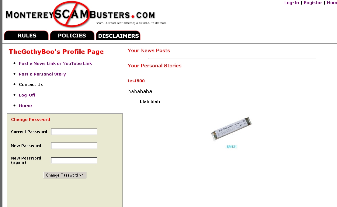

 Now I have the weirdest error - started running test for the site found a weird error I redid every form and look all through the back end but cant figure it out.
a new user can post a "story" it  adds a record and posts to everything every where perfectly
but when any one but admin post to "news" it adds the record but nobody can see it expect the in backend it wont post to anything on the web site.
I dont know where to go from here its just so odd!
Here are 2 screen shots.
Patricia
www.thenetgirl.com

By Daryl - August 2, 2013
Greg and I think that the issue might be related on how the users are set up in your website membership plugin.
Would you mind if we take a closer look by submitting a second level support for us?
