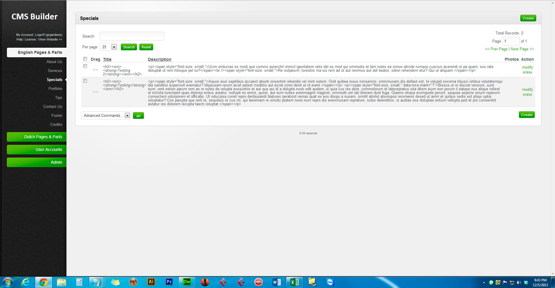

Can someone help me with the wysiwyg of CMS Builder v. 2.53 (Build 1040),
I added two field Labels "Title" and "Description" with field type "wysiwyg" in a Multi Record Section, but when I see my records in the CMS Builder interface I see the tags with the text.
E.g. for "title" I see:
<h2><em><strong>Testing 2</strong></em></h2>
E.g. for "description" I see:
<p><span style="font-size: small;">Ucim enducias es modi que comnis porerchil imincil igenitatem velis del es mod qui ommodis et lam nobis ea simus alicide rumque cuscius acerendi ut pa quam, sus rate doluptat ut rem hilisque pel iur?</span><br /><span style="font-size: small;">Re nulparum, torestiis ma ius rem ad ut aut renimus aut adi beatur, odion rehendem etur? Qui ut aliquam.</span></p>
Is their a way to see the list of records in the interface without tags (plain text) or formated the way it should look (bold, italic, size etc.)?
I also attached a jpg for preview.

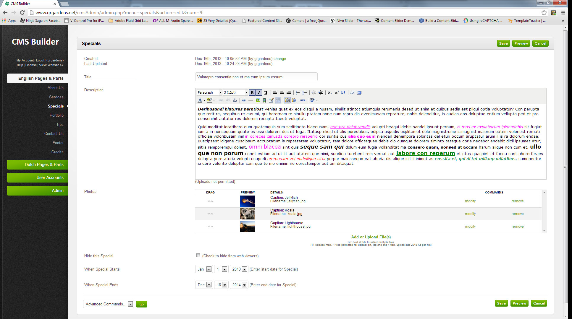

Today I got a chance to test the way the wysiwyg shows.
It does show all formating.
It shows size, bold and underline.
It does not show color in conbination with bold formatting...!!!
Is this possible?
I would also like the option to display plain text (NO-FORMATTING) when viewed in the Records list.
I attached 2 screen shots as refference.

By Damon - December 17, 2013
Hi Tim,
In both screenshots, the text "omni blacea" appear bold and pink. Can you give me an example?

Hi Damon,
The "omni blacea" isn't bold!!!
And the problem is bold... it doesn't show color in Multi Records List.
What is strange is that an underline bold text displays the underline in color and the text in black in Multi Records LIst.

By Damon - December 18, 2013
Hi Tim,
The problem that is happening is that the WYSIWYG content that is displayed in the Multi Records list is picking up some styles from the CMS Builder admin CSS.
Maybe there is another way to get the results that you are after outside of the admin. What about creating a password protected multi record list page on the front end of the site with links to edit?
You could have the content display exactly as needed and the user would already be logged in, so when they clicked an edit button, they would go right into the admin edit screen for that record.
Let me know if this makes sense and may be an option.
