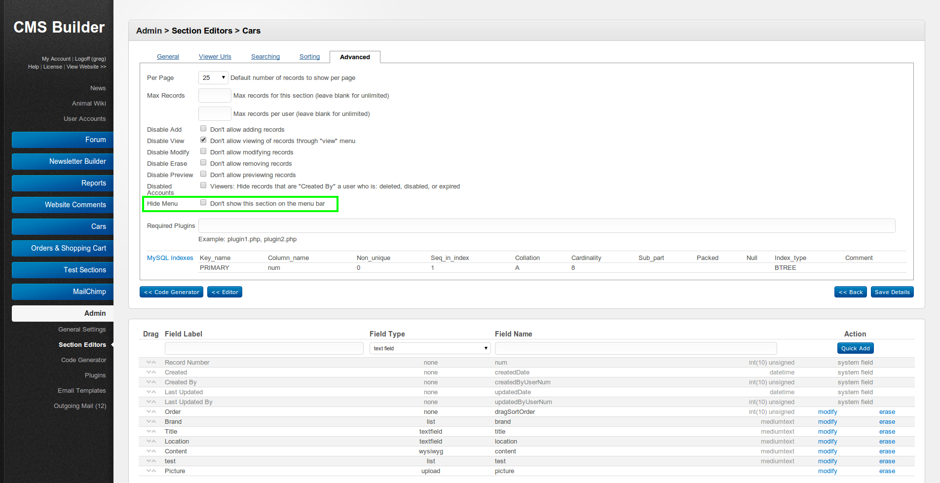

It's likely that you're not seeing the section in your left hand menu list because the section has been hidden from the menu. You can change this by editing the appropriate section from the Section Editors menu, then going to the advanced tab. You should see a checkbox called Hide Menu, uncheck this if it's checked, and the item should appear in the menu (see attached screenshot).
