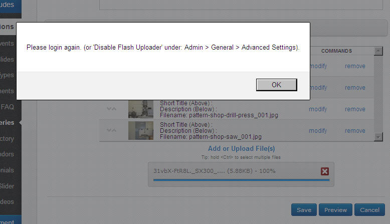

I just logged in to a 2.63 install for the first time today using Firefox v33 and did a test upload of an image.  I got the message (see attached) so I did the upload again and all subsequent uploads work fine.  Since Firefox is my preferred browser, I have gotten accustomed to the first upload being rejected but it is an aggravation I could easily give up! LOL
Ron Conring
Conring Automation Services
log-in-again.jpg 48K
