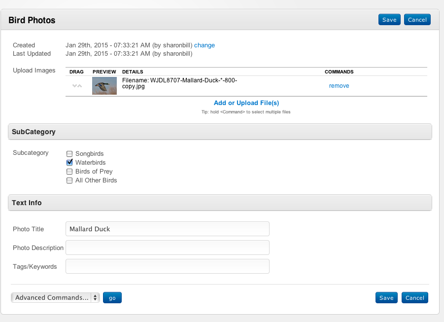

Yes, there is a table called bird_photos and ALL birds were already entered into it when the client decided they wanted them easily divided into subcategories (Songbirds, Waterbirds, Birds of Prey, All Other Birds)
I've included a screenshot of of section editor & editor pages. I'm also attaching my revised php page. I have managed to make something that resembles progress. Here's the page link:

I think the actual structure - multiple getRecords calls to get the first in each subcategory - is the simplest solution. You're just missing a few key variable names.
I've amended the file - see attached. It's untested, but I really just cleaned up some of the code.
