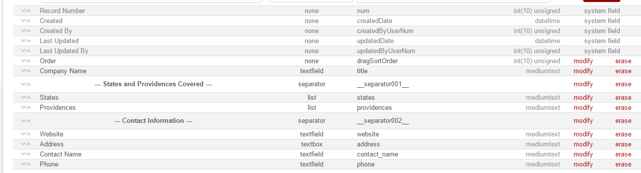

What's the 'states' field in the distributor table look like? Is it a list?
Claire Ryan
It is one of two lists that is used inside the distributors list (see attached)
So there is the loop of States with a loop of distributors inside of it and then there will also be a loop of Providences with a loop of distributors right afterward. So you are only seeing the code for the first loop.
I was hoping to replicate the solution for the Providences once I had that. Just needed to get it working properly.

Okay, what kind of list is it? A dropdown? A multiselect? Checkboxes?
Claire Ryan
By claire - February 4, 2015
Claire Ryan
In this case I used a pull down multiple choice list. But I usually use check boxes.  Are there separate ways to express both?

By claire - February 6, 2015
Hi Michael, sorry for the delay on this.
If the states are stored as a multiple choice, then it shows up in the database a little differently and thus the where clause needs to be changed. So try this instead:
