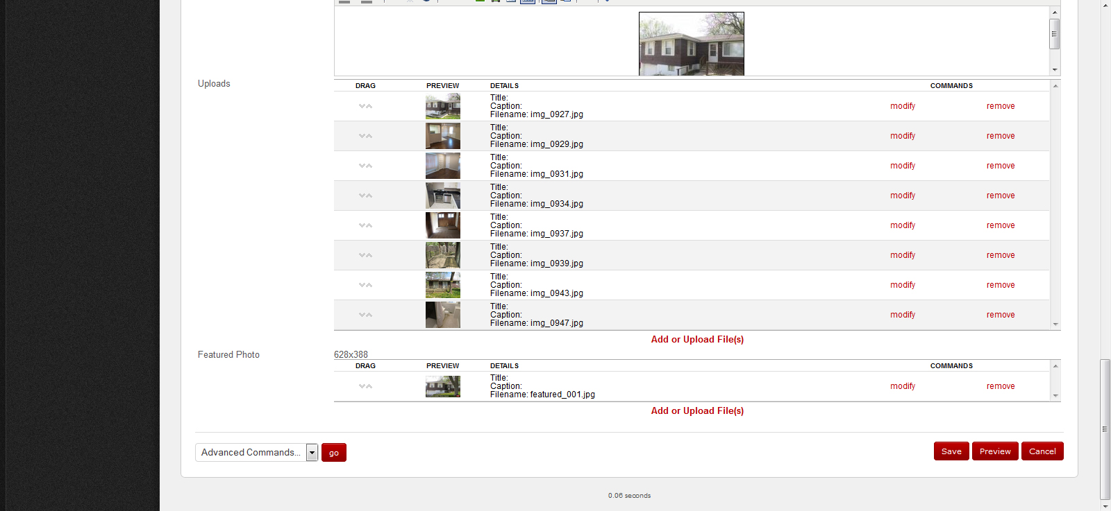

Is their a way to add a descrption for the featured images like they have in the example below.
I think their is some way when uploading to add a description in one of the extra fields, but not sure how that works.

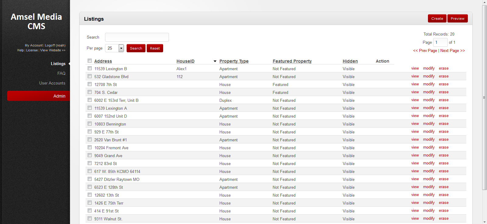

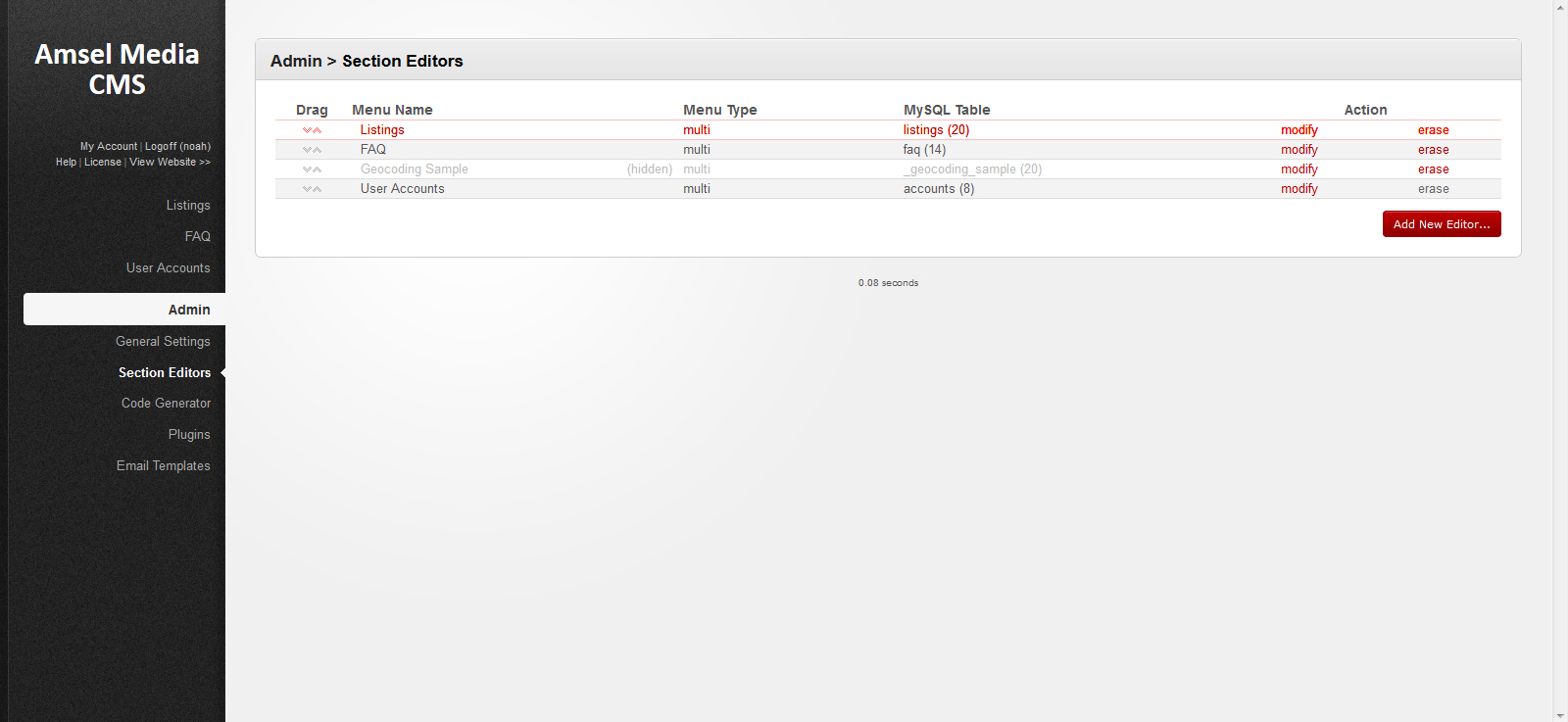

This is a different question but in the Admin > Section Editors their is a Drag field where you can move the columns around.
Is their anyway to add that feature to the Listings section so I can rearrange the houses where I want them?

You can display upload image caption text using this publish code:
<?php echo htmlencode($upload['info1']) ?>
If you add this into the code it should work. If it doesn't, compare the results (view browser page source) with a working version (page source) to see where the code is the same and different.
