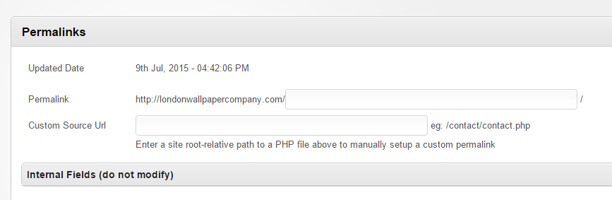

I cannot understand what I did wrong as I have compared it with another site and idnt have this problem.
I see the permalink is shown as http://mysite.com rather then http:///www.mysite.com
See attached photo.
I do need to have the www as I will also be having a mobile site . (I am aware permalinks cannot do mobile at the moment and will do the htaccess code for mobile site by hand)
Can you advise as to how to get the www in my permalink please.
regards
Kenny
permalinks-www-q.png 23K
By gregThomas - July 9, 2015
Hey Twocans,
I took a look at the permalinks code base and the label on the permalink box is based on the current domain you're accessing the CMS from.
When you change my address from non www to www, the label for the permalink on the page also updates to include www.
When the permalink system runs it works off the URL path, and doesn't take  the actual domain into account. The label on this field is just to guide CMS users. So you don't need to worry if the label doesn't have the correct domain appearing in it.
