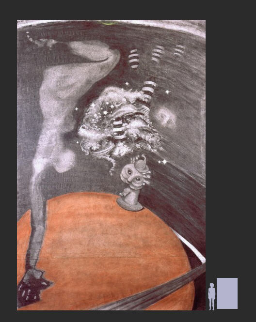

By gkornbluth - July 13, 2015 - edited: July 13, 2015
Thanks for looking at this.
An example of using the 2 images in the same slide is attached
The little grey size_image images are different for each large image and are to show relative sizes of the larger image of the artworks since the artworks vary from small 8"x10"  works to 40" x 60" works
The appropriate size_image is uploaded to each image record in the home_page_slide_show_2015 editor.
Best,
2 image examle.jpg 53K
