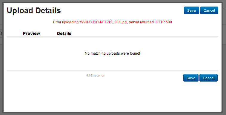

I'm running into an odd problem that I can't seem to track down. I'm hoping someone else may have experienced something similar and can help.
I recently upgraded our web server and it is now running PHP v5.3.10-1ubuntu3.19. This, plus the update to MySQL v5.5.4400 were really the only changes to the server.
Most of the sites are running fine, but one in particular is giving me some problem when I try and upload files. These could be PDF or JPG. The really odd thing is that I will get the error with one PDF file, but can upload another with no problems. In the case of trying to upload images, I get the error if I try to upload an image, but not if I try and upload a PDF.
I have attached an image of the error message I am getting. I have tried to rename the files with no luck. I am running CMSB 2.63. It was on a much older version and I thought that may be the problem, but upgrading CMSB made no difference.
Any thoughts will be greatly appreciated. This is the first time I've run into something like this. I do not see any errors in the Apache logs to help me track down the root of the problem.
pcolvin
By pacolvin - July 23, 2015
Looks like I may have found the problem. I need to do some more testing to be sure, but so far so good.
My server is running Fast CGI. I finally found something in the site's error log that helped to track it down. It seems the HTTP Request Length in the fcgi.conf did not come over from the upgrade. I added the settting MaxRequestLen 15728640 to the fcgi.conf file and I can now upload again.
I wanted to put this out there in case someone else may ever run into this problem.
