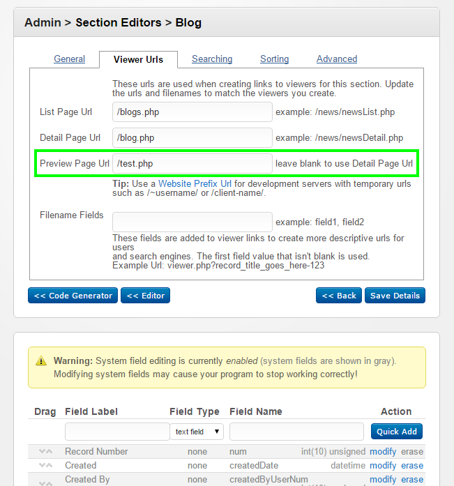

Here are the steps to create a preview page:
  1. Go to the code generator, create a detail page that uses  Multi record sections: Get record # from end of url. eg: viewer.php?record_title-3  for which record.
  2. Put the generated code into a PHP file, in my testing I used a file called test.php.
  3. Edit the section and under the viewer URL's tab, enter the path to your preview page (See attached screenshot).
Now when you edit a record you'll have the option to preview it.
CMS Builder.png 83K
