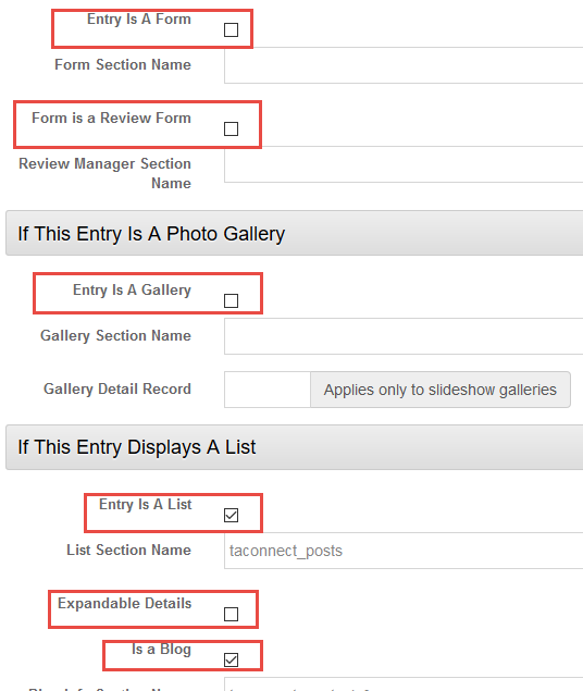

With CMSB V3.02, the checkboxes do not align with the prompting text.
See the attached image
2016-03-02_11-45-05.png 29K

Awesome - I just made a quick little change to edit_functions.php
  //TA Mod
  if (empty($description)) { $description = " "; }
  //end TA Mod
in the function _showCheckbox and it seems to have fixed it up.  Much easier than changing 50 or 60 section schema files.
