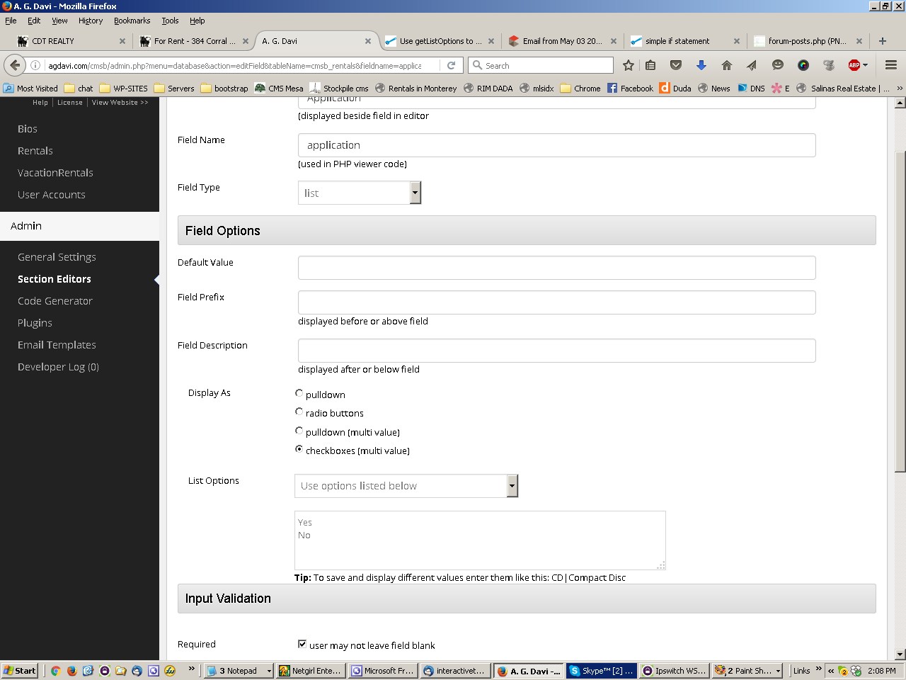

By gregThomas - May 3, 2016
Thanks! I notice that you're using a multi option pull down so that a record can have both Yes and No as options at the same time. If you change the display as option to pull down (see attached image), then you can use the following code to display the record where application is Yes:
<?php if ($rentalsRecord['application'] == 'Yes'): ?>
Oops! See attached!
forum-posts.jpg 206K
