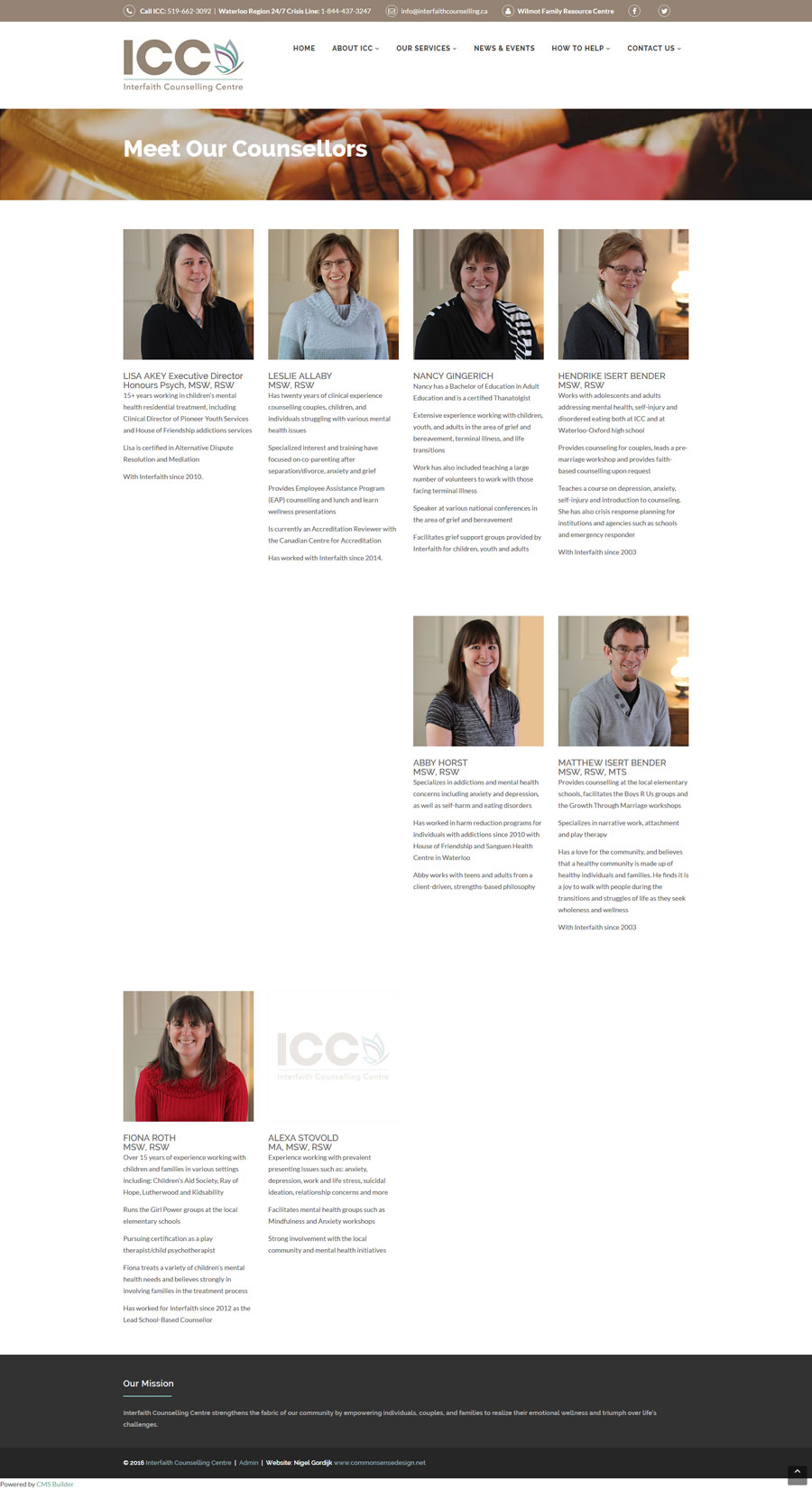

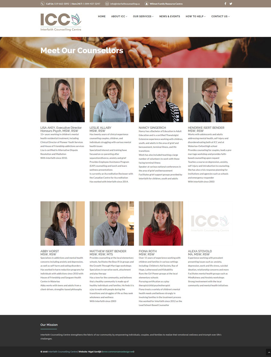

I did a version of my client's page before adding CMSB, which you can see here: http://www.commonsensedesign.net/extranet/icc/about-counsellors.php. On a wide screen, there are two rows of four columns. When I adapted this to work with CMSB, the columns don't align properly: http://interfaithcounselling.ca/about-counsellors.php.
Please see attached screengrabs.
I've also attached a static version of the page - which lays out as it's supposed to - and the CMSB version (about-counsellors.php).
Any suggestions, please?

Definitely not CMSB related. It's HTML/CSS/Content.
The issue you're seeing is related to the amount of content per column container. Since you have one row with all the "col" containers within, they wrap and float left.
In "desktop view" the 5th bio listing is being "caught up" by the 2nd bio listing. (you can see this by using the Web Developer tools built into the browser and enabling the Outline of Block Elements, and comparing the pre and post pages you posted - you can see the amount of content within the bio box has changed).
There are different ways you could approach this. One would be to use PHP increment and output a close/open div for another row every 4 listings (this would help for the desktop view - but you may possibly run into a container getting "caught up" on the tablet view with the collapsing responsive layout). Could try min/max height values for the bio listings as well. Many other CSS/HTML solutions as well.
Hope this helps!
