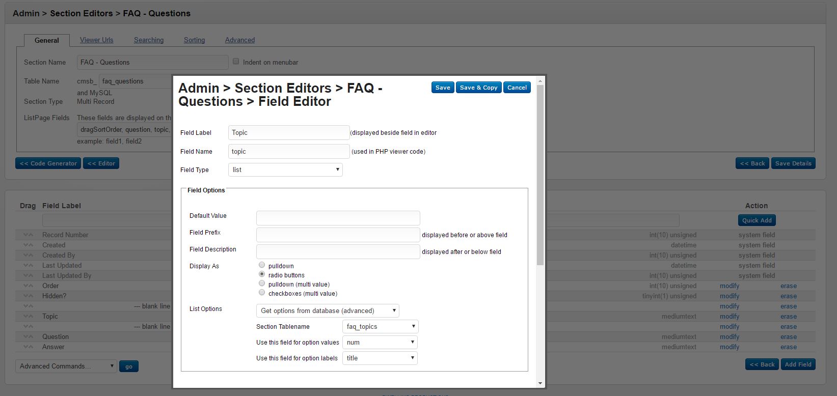

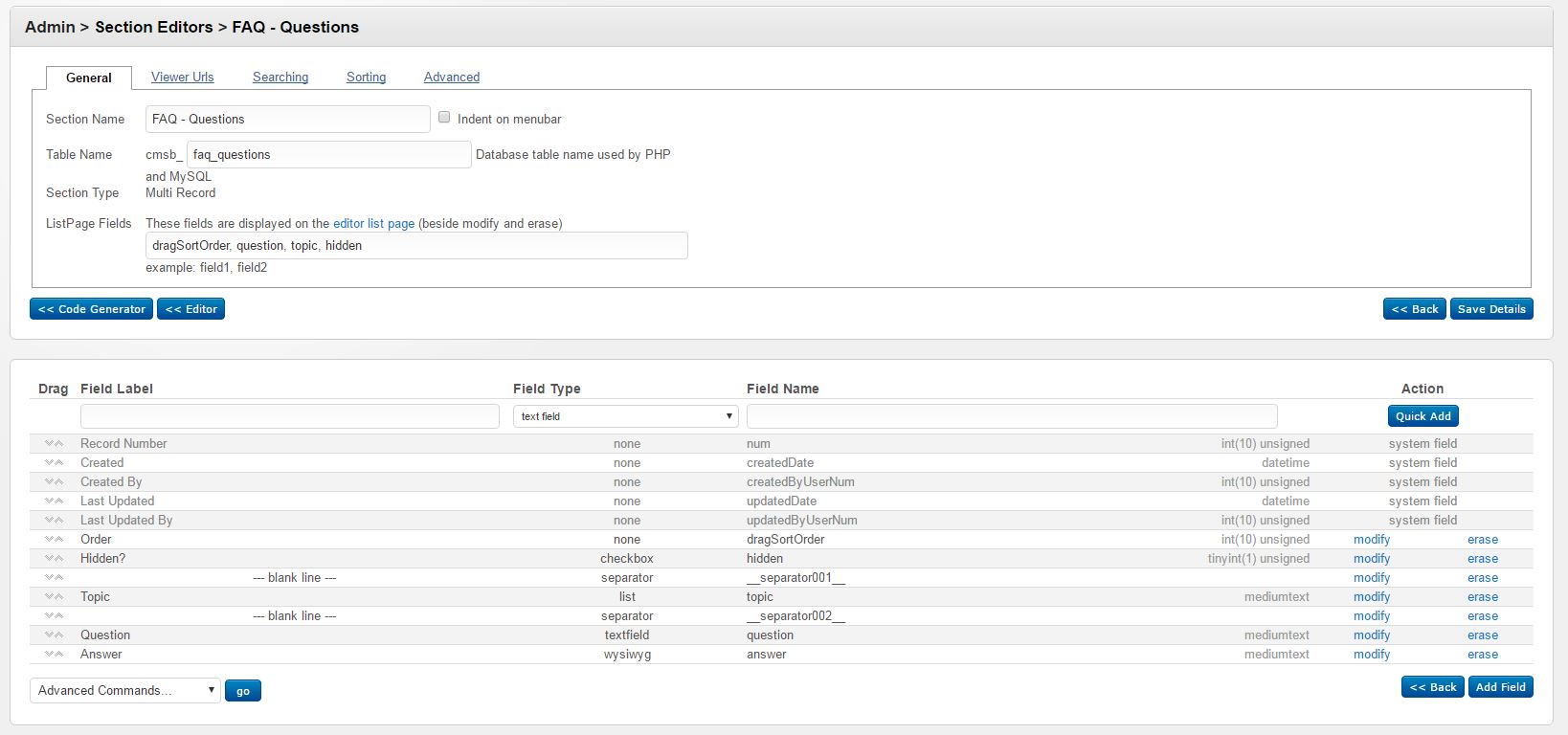

For this example, in CMSB, I have a multi editor where the client add questions (faq_questions) and they can select a category radio button which is supplied by a category multi-editor (faq_topics).

In case they are needed, the field names I'm working with are:
For Categories: faq_topics: 'title'
For FAQ Items: faq_questions: 'question', 'answer', 'topic' (the list which pulls topic titles from the above 'faq_topics")
