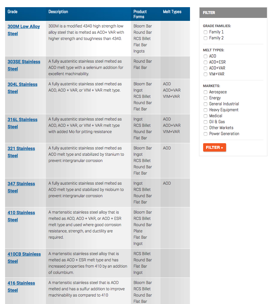

I am familiar and comfortable with the custom WHERE, but I'm not sure how to utilize it in this situation. How would I inject in custom criteria for the WHERE from the URL? Attached is a screen grab of my page, in case that's helpful.
