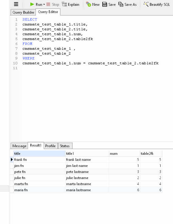

I have been testing the CMS trying to get a better understanding of it. I wanted to try completing a join.
I have a simple join and it works, I attach an image showing both the full sql and the results.

I have a little question about the foreach, I have the foreach below. and it works showing the info from the test_table_1 table,
http://www.matesee.com/zjoined.php
<table width="760" border="0" cellpadding="10">
<tbody> <?php foreach ($test_table_1Records as $record): ?>
<tr>
<td><?php echo htmlencode($record['num']) ?></td>
<td> <?php echo htmlencode($record['title']) ?></td>
<td> </td>
<td> </td>
</tr> <?php endforeach ?>
</tbody>
My question is how do I also call from the other table, at present I get all from test_table_1 in the foreach statement, what would I have to do for the test_table_2, do I need a nested foreach.
