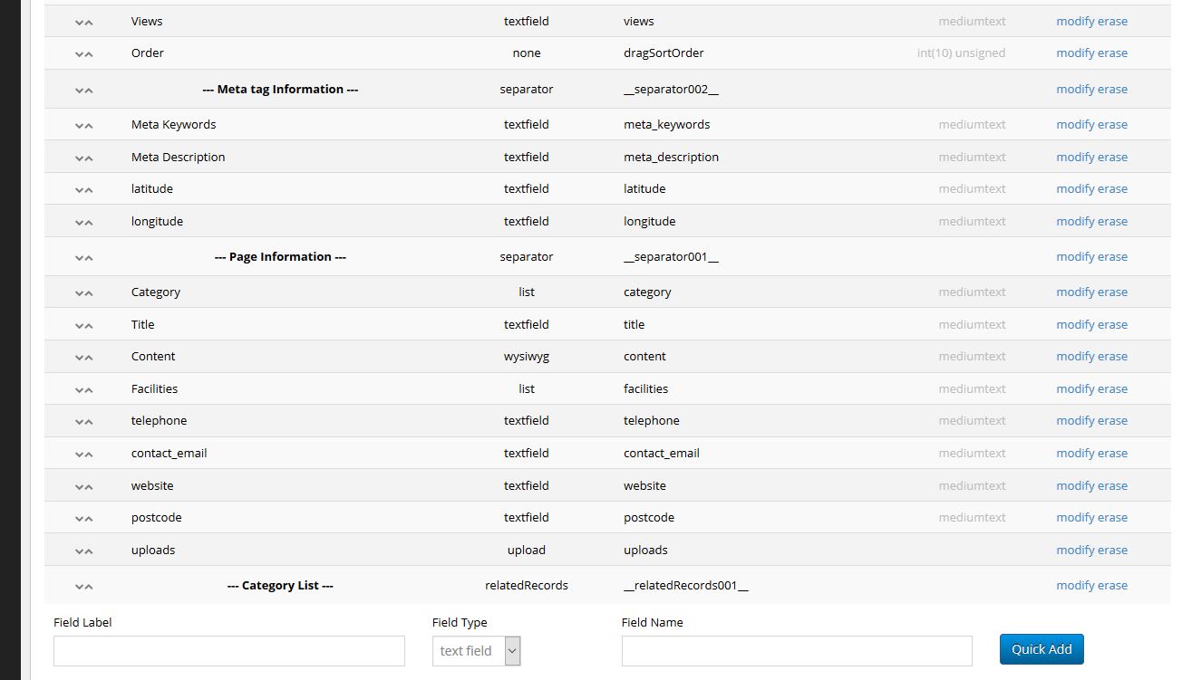

To this end both tables will have a field called "category" and to ensure matching content  I want the "category" list field in the table "information_section_headers" to populate itself using the content from the "category" field in the "information_pages" table. Hopefully this still makes sense.

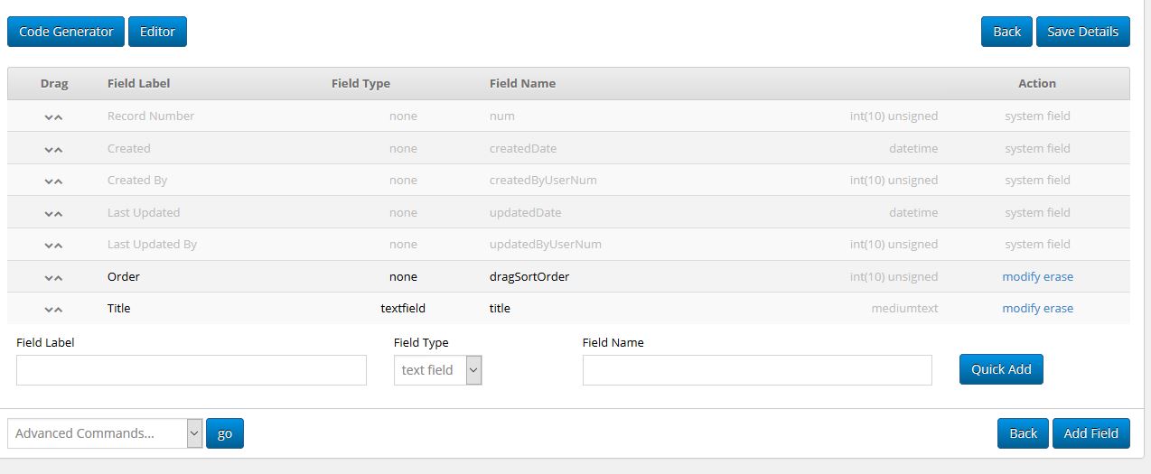

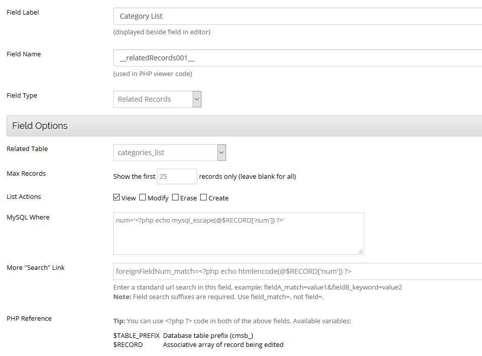

Unfortunately while I can start setting up the category field in the second table and get as far as the dropdown box to select the table to be used to import from I have no idea what code is needed to replace the default entries in the MySQL Where box or the More Search link box.
If anyone can advise as to what I need in there to populate the field with the list content in the "category" field of the first table it would be appreciated.

  • Create a new section called: Categories
  • Only have these fields in it: num, name
  • For any sections that you want these categories in, create a list field with: Get options from database (advanced)
  • Select the category table as the Tablename, num for "values" and name for "labels"
Note: I'm using "num" as the stored value, which means you'll need to look up categories like this: category=4, you can use text if you want.  The benefits of using record numbers is that even if your text changes the records are still linked.
By Dave - August 9, 2017
Hi willydoit,
Instead of a related records field, can you try creating a list field?
By willydoit - August 9, 2017
that sorted it, thanks, that,s opened up a whole new world of possibilities now. Thanks again for your patience, it is appreciated.
