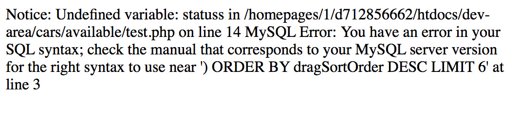

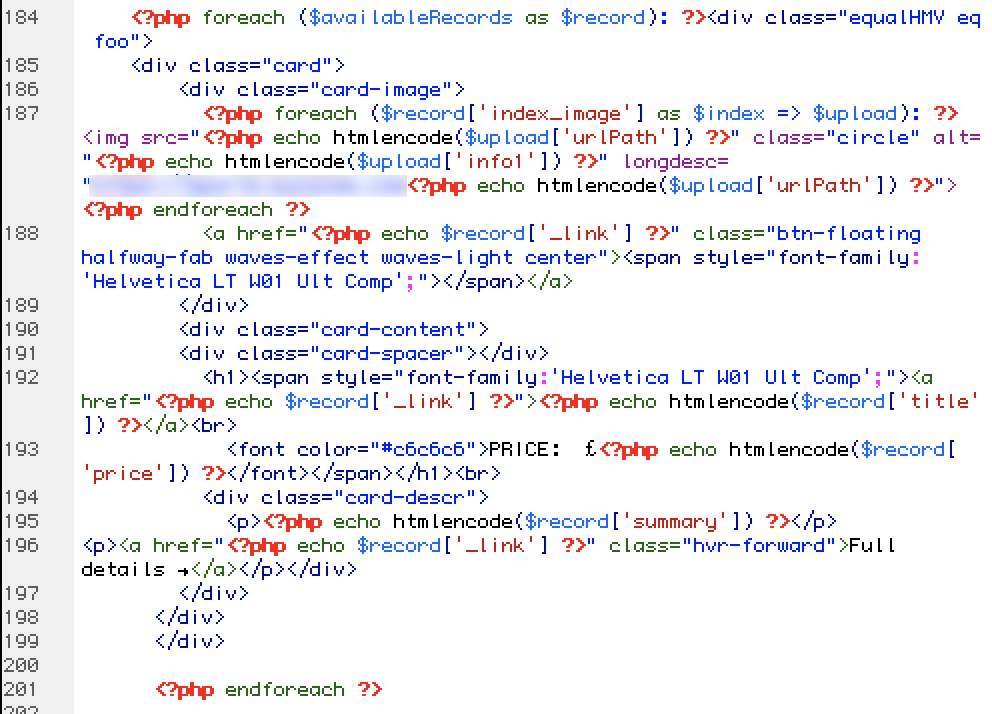

Hi Leo ... I tried that but I'm getting an error on the test page.
I've uploaded the head code and also code in the html calling in records and also screen grab of the error when visiting the page.
Is there anything you can see that I need to do?
I added the new field called 'statuss' in the CMS as it said 'status' was a reserved field. This is running from a multiple section call 'available'.

By leo - March 5, 2018
Hi Adrian,
Sorry for the confusion. Basically you need to define $statuss first before passing in to the where statement. For example, your statuss field in CMS is a list that contains following values:
1|Available
2|Sold
3|New
* This is the default CMS list value format, the number on the left represents the actual value of the option and the text on the right represents the label
And on the page with records that marked as "Available", you can do this:
$statuss = 1 // 1 is the value of "Available" option
list($carsRecords, $carsMetaData) = getRecords(array(
  'tableName' => 'cars',
  'where' => 'status = ' . $status,
Or even more straightforward if you think this page won't need to get other records:
  'where' => 'status = 1',
Hope this helps you get what you want and let me know if you have any questions!
