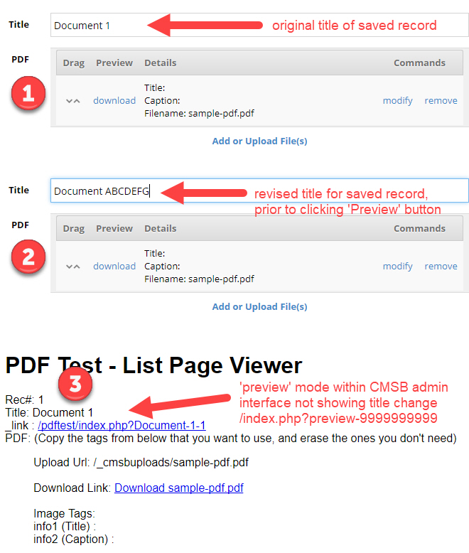

Saved changes show in "preview" just fine. However, there's no need to "preview" something already saved, just a record actively being edited BEFORE it is saved... which is how I'm interpreting the term "preview". What other type of "preview" would there be?

This is a multi-record section. When a change is made to an existing record field, the 'Preview' shown using the 'Preview' button within the CMSB interface does not show the update made to that field.
Please see attached screenshot sequence.

Yes, the list page doesn't show edited content, so you'd need to create a custom "view record" page and set that as the preview url.
Since the page only exists for mockup/preview purposes you can even add some content to indicate that is the case, but still have it give them a sense of what the final output will look like.
