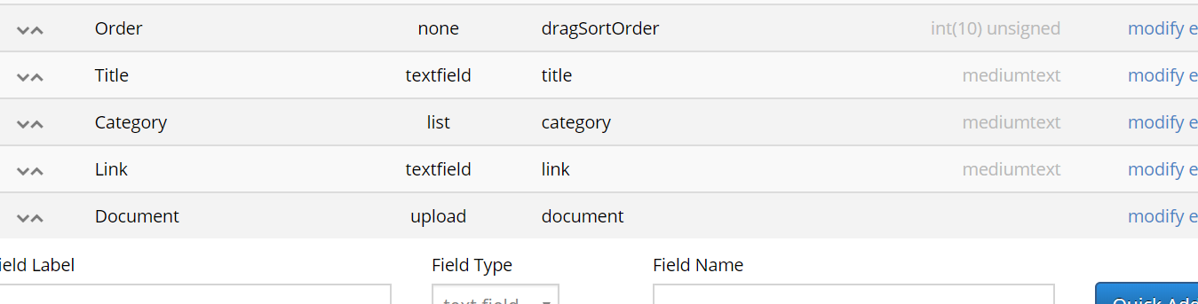

By Mohaukla - April 10, 2018
Hey Leo
I changed it to $categoryLabel which now it is showing the category "number" but not the actual title of the category.
Both the category list and the docs/links list have a "title"
And the docs/links section does have a "category" field as it is a list pulling the of "category" list into it. (see attached image)
So I am seeing where you're going but something is still missing.
What do you think?
Michael
Owner of Just Rite Design Inc. A growing network of professionals in web design, graphic design, flash development, programming, and audio & video productions.
"Due to budget constraints, the Light at the end of the tunnel will be temporarily out!"
By leo - April 10, 2018
Hi Michael,
Try changing your array_group function to this: array_groupBy($resource_links_docsRecords, 'category:label'); and it should be good!
