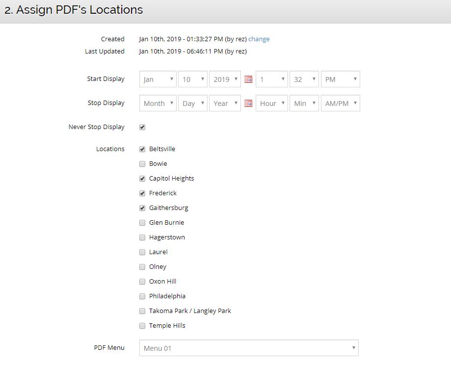

Attached a screen shot of the editor where you assign locations from one editor to pdfs from a 3rd.
Need to list out all locations with appropriate PDF. Currently, there would be no way to stop multiple PDFs being assigned to a location. I'm fine with that. An admin can look at the list on the display page and quickly see there should only be one.
