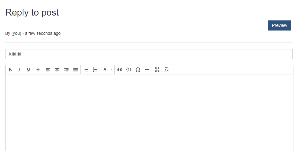

I'm still able to view the WYSIWYG fields when I check (see attached screenshot). I did forget to mention in my last post that, as the issues were in JavaScript files, the corrupted versions may be cached by your browser. Could you try clearing your browser cache, using incognito mode, or checking in a different browser?
Let me know if that helps, or if not, a specific page where you're still experiencing the issue?

Hi Daniel
Indeed when I checked it in Incognito mode it worked.
