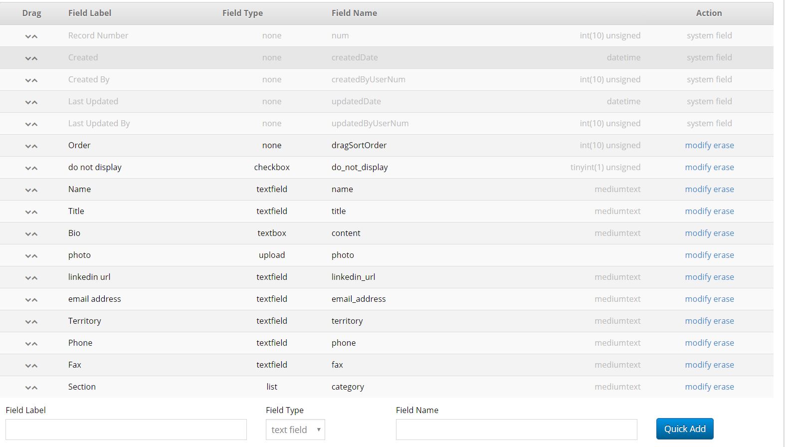

Funny enough, that is the post I was referencing in my initial posting that I did not understand (pasted below) - Damon makes reference to "the hidden checkbox on the record" which I could not find at all (unless it is staring me in the face) and "adding the following to the view options" and I was just unclear if it is the view options on the page (like below) or somehow in the CMS section.  I wasn't sure if I was just supposed to create a "hidden" checkbox field and magically it would adopt those properties but since my "do_not_display" field was essentially the same thing with a different name. I included a screenshot of the current fieldlist in the leadership_sales section.

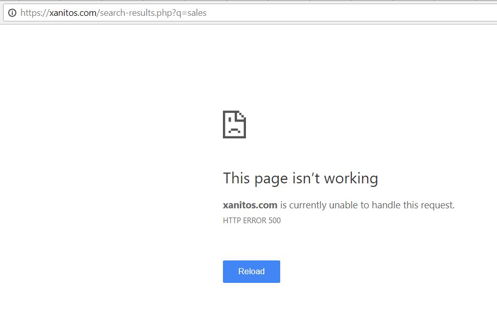

Thank you again, but unfortunately it did not work -   when i put that in I get a 500 series error (see attached).

I had the same thought this am - the section editor does indeed indicate that "hidden" is a special field type but the 'ignoreHidden' => true,  statement still causes a 500 error on the page. I feel like we are close but there is some (critical) piece of information I am missing.
