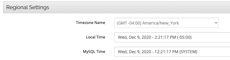

I recently updated a site to v 3.54 and I am experiencing a problem with publishDates which seems to stem the timezone setting in General Settings. I have the timezone set to my local timezone, which then displays local time and mysql time to be 2 hours apart (see attachment). This leads to items using the publishDate field to not appear on the site until 2 hours after intended.
timezone-settings.png 26K
