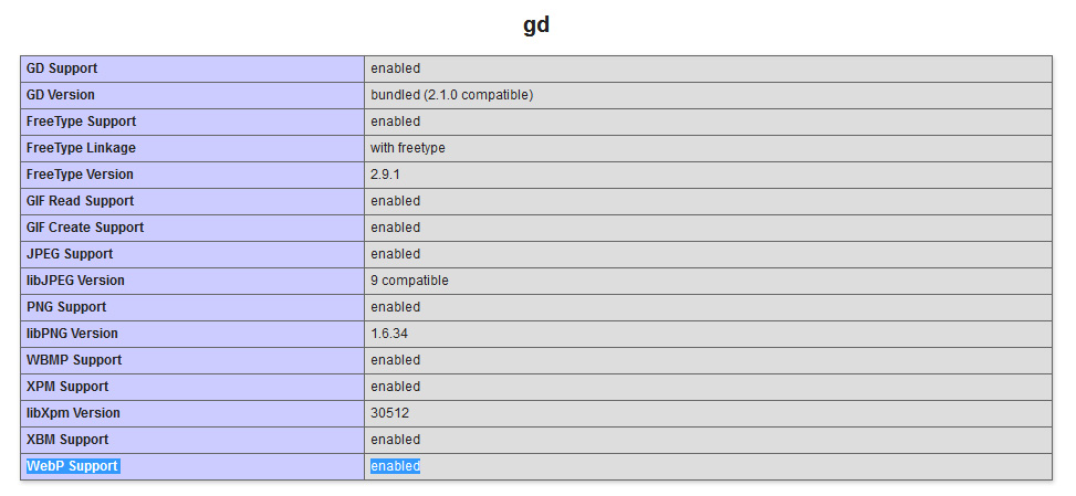

Can you tell me a bit about your server environment? OS, PHP version, etc. It's possible your server doesn't have WebP support enabled. You can verify this by checking the output of the phpinfo() function. You should see WebP Support enabled screenshot attached.

I've checked phpinfo() and get the same as your screenshot, WebP support is enabled.

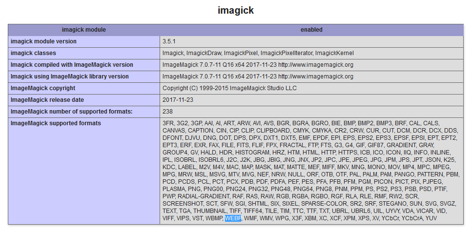

Can you check the Imagick section on the phpinfo() output to see if WebP is listed there? I've attached a sample output of what we're looking for here.

By pault - November 29, 2021
Hi Michael,
WEBP isn't listed there. Is it possible to get CMS Builder to use GD instead of ImageMagick? Or do you think there's another workaround?
Thanks, Paul.
By Michael - November 29, 2021
Hi Paul,
In your particular case it looks like ImageMagick is not configured with WebP support.
I would start by requesting that your hosting provider add WebP support to the ImageMagick configuration on your server.
