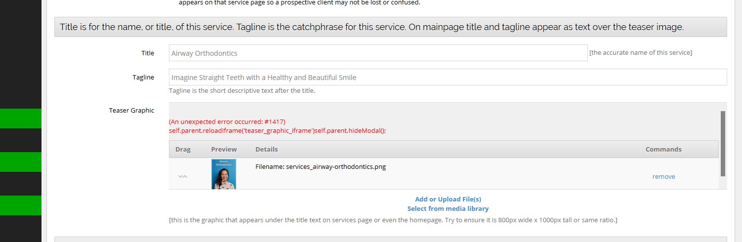

Challenge with .png graphic uploads - causing error "(An unexpected error occurred: #1414) self.parent.reloadIframe('teaser_graphic_iframe')self.parent.hideModal();"

I've done some looking into this issue, and couldn't find a conclusive cause. This appears to be an error coming from PHP's image creation library (GD), which may signify something unexpected to do with your particular PHP installation, or the PNG files themselves. If they aren't sensitive, could you attach one of the PNGs that has given you trouble so that I'm able to run some further tests?

I am attaching several of the actual .png files that errored (but still uploaded and were visible) as requested.  HOWEVER, let me state what has occurred in the interim. I engaged the WebP option on this particular site and the errors ceased. SO, I turned webp back off and ran some tests -- the same .png files that were previously having problems...no longer do.
So, I went to a 2nd site that I also recently updated. This one is the most recent version of CMSB 3.56 (build2304) - the next version after the first site mentioned (3.55, bld 2297).  Upon uploading the very same .png (with webp off) files (ANY .png actually) causes the same error mentioned earlier.  If I then turn webp on, the .png error goes away (and using same files). Then turn webp off, remove cookies and temp files and open new browser, then upload a .png and get the error again. I can then turn webp on, no error. Turn off, error. Back on, no error...Consistently.  If you need a temp login to that particular site, let me know and I'll provide one.

Thanks for the additional info. A curious issue to be sure - uploading those images to my test environment doesn't produce any errors, so it points to something related to the specific libraries available on the server. Could you test out the following patch for me? In /cmsb/lib/image_functions.php, replace this line (at or around line 42):
case IMAGETYPE_PNG:  $sourceImage = imagecreatefrompng($sourcePath); break;
With this:
case IMAGETYPE_PNG:  $sourceImage = @imagecreatefrompng($sourcePath); break;
This should hopefully silence the error. As the image still uploads correctly, that may be sufficient.
