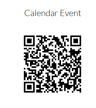

I'm working on a site utilizing CMSB 3.56 bld 2304, and QRCode Generator 1.02. I was just putting up a simple qrcode sample page and noticed that the "event" type is not able to provide the correct time...It seems to always be 5 hours earlier than coded in...no matter what I change the start and end time to. The following returns the correct date but start time shows as 5:30 and end time is 6:00. Just so you know I have scanned using several different devices and scanners...it's consistently happening across the board. I have attached a screenshot of the generated QR Code as well.

Sorry for the delay in responding ~ I literally just got back to this part of their project. Your solution mostly worked. I have attached a screen shot of the before and after. While the time for the event was pulled, correctly, from the default/globals as you wrote, unfortunately a bunch of text was inserted between the title "Calendar Event" (in red) and the qr code sample just below it.
If we can correct that portion then we have a solid fix.
