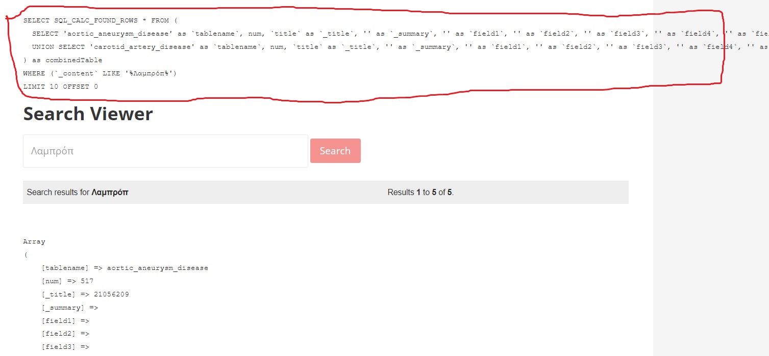

  1. On top of search results there appears some text which I cannot get rid of (see image 1)

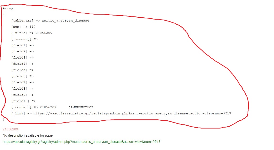

  2. The results are correct but there is a bunch of information which I do not know how to modify them (see image 2). Also I do not know how I can modify Field1, field2, etc

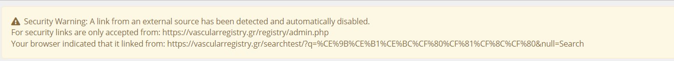

  3. On the link for each one of the results records there appears a question-mark (see image 3) and when I click on this link a warning appears (see image 4) which does not allow me to open the record

1. The sample multiSearch.php starts with the "debugSql" search option set to 1 - you can either change this to 0 or remove it entirely, which should remove that output.
2. This portion of the code is where you can change the returned values:
      $searchTables['news'] = array(
        'viewerUrl'       => 'newsPage.php',
        'titleField'      => 'title',
        'summaryField'    => 'summary',
        'searchFields'    =>  array('title','summary','content'),
For example, you can change "title" and "summary" to the appropriate field names in your table. As well, you can use field1, field2, etc. to add up to 10 additional fields, like this:
        'field1'          => 'content',
        'field2'          => 'category',
3. The link-building portion of this function is currently incomplete - I would recommend constructing your own links in the page's output.
Regarding the warning: if you need this to open viewer/editor pages in the CMS it will need to be built into a plugin - I had forgotten that it's not possible to directly link to the admin from non-admin pages. Otherwise, if it'd work to view/edit on the front-end like you're doing with this test page, the simplest way would be to either use a regular details page from the Code Generator (view) or use the Form Generator with record editing enabled (edit).
