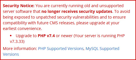

Hi, all. After my client has logged in to CMSB and chosen the section that they want to update, they get redirected to the login page again. They're stuck in a login loop that they can't get out of! Any idea what might be causing this, please? I can't replicate their problem, as I'm able to login and create or edit pages without any issues.
They're running v3.54 of CMSB.
It looks as if their server could use a PHP upgrade anyway, but that doesn't explain why CMSB works for me, but not them.
