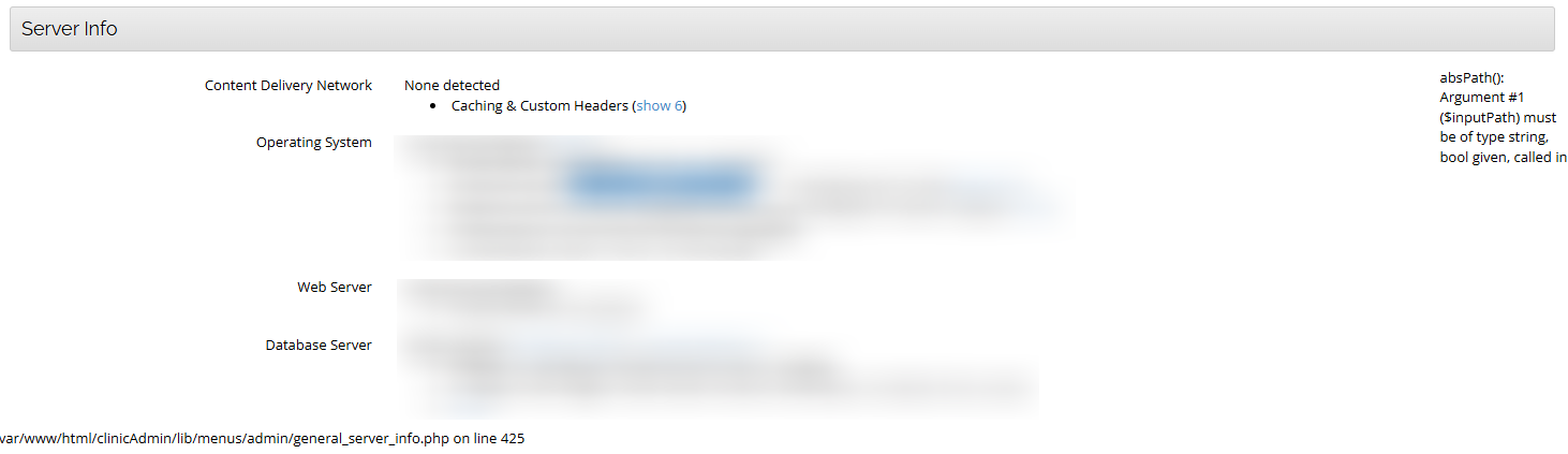

When loading /admin.php?menu=admin&action=general, it errors with:
absPath(): Argument #1 ($inputPath) must be of type string, bool given, called in /var/www/html/clinicAdmin/lib/menus/admin/general_server_info.php on line 425
as per attached screenshot.
Coming from:
general_server_info.php L425:
$loadedPhpIni  = absPath(php_ini_loaded_file(), \CMS::$rootDir);
file_functions L10:
function absPath(string $inputPath, string $baseDir = '.'): string {
Not sure if it's something specific to my server config causing this, but it's happening in both DEV and PROD.
Obviously not fatal, but annoying none the less as it triggers a Dev Log error email everytime someone accesses this page.
Cheers
Rob
General Settings.png 129K
By Tim - June 11, 2025
Hi Rob,
php_ini_loaded_file() could return a false if PHP can't determine if an actual PHP.ini file is being loaded. This could mean your servers are running with default values and not the values you specified in a PHP.ini file when setting up PHP. One way you could check if this is the case is to go onto your server command line and run
"php --ini"
and see if the file path it reports actually points to the php.ini file you think it does. If they file doesn't exist, it may be running on defaults which could be problematic if you are running a production server.
You can also check phpinfo() and see what it pulls in for settings and which file it reads from.
The problem is that if PHP is not reporting a php.ini file being loaded, it returns false to absPath which expects a string (perhaps we can make that section more robust as well) and hence the error you are seeing.
Let us know what you find out. :)

By runriot - June 11, 2025
Hey
Both PROD and DEV are inside Docker containers, so maybe that's contributing to this?
phpinfo():
Configuration File (php.ini) Path: /usr/local/etc/php
php --ini:
Loaded Configuration File:         (none)
Scan for additional .ini files in: /usr/local/etc/php/conf.d
Additional .ini files parsed:      /usr/local/etc/php/conf.d/docker-php-ext-gd.ini,
/usr/local/etc/php/conf.d/docker-php-ext-mysqli.ini,
/usr/local/etc/php/conf.d/docker-php-ext-sodium.ini,
/usr/local/etc/php/conf.d/docker-php-ext-zip.ini,
/usr/local/etc/php/conf.d/uploads.ini
So php --ini inside the container doesn't seem to report a loaded config file, but that's ok (I think) as we haven't seen any problems with this config for years now...! Pretty sure everything is well handled by the docker container base image. We are setting a few non-defaults in uploads.ini
Thoughts?
Cheers
Rob

By Dave - June 11, 2025
Thanks for the report, we've fixed this for the next release.  Here's a patch:
In /cmsb/lib/menus/admin/general_server_info.php, search for $loadedPhpIni and replace this:
$loadedPhpIni  = absPath(php_ini_loaded_file(), CMS::$rootDir);
$configFiles = [  // check which local config files are in use
                  $cmsbHtaccess  => str_contains(ini_get('highlight.html').ini_get('date.default_latitude'), 'CMSB_CONFIG_HTACCESS') || ($_SERVER['CMSB_APACHE_HTACCESS'] ?? $_SERVER['REDIRECT_CMSB_APACHE_HTACCESS'] ?? false),
                  $cmsbUserIni   => str_contains(ini_get('highlight.string').ini_get('date.default_longitude'), 'CMSB_CONFIG_USER_INI'),    // || in_array('102M', $_maxSizes)
                  $cmsbPhpIni    => str_contains(ini_get('highlight.comment').ini_get('date.sunrise_zenith'), 'CMSB_CONFIG_PHP_INI'),      // || in_array('103M', $_maxSizes)
                  $loadedPhpIni  => 1, // add last as it will overwrite previous entry if they're the same and in that case we want isLoaded to be true
with this:
$configFiles = [  // path => isLoaded, check which local config files are in use
if ($loadedPhpIni = php_ini_loaded_file()) {
    $configFiles[$loadedPhpIni] = 1; // add last as it will overwrite previous entry if they're the same and in that case we want isLoaded to be true
Thanks - and yup, that fixes the issue.
