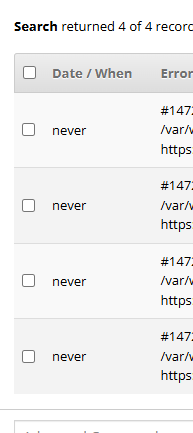

Errors logged into _error_log are being inserted without a dateLogged, so they appear as "never" in the UI, as per attached screenshot.

devlog.png 16K
