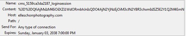

*** The only issue that seems to remain is that when I use the logoff code, <a href="http://www.elleschorrphotography.com/cmsAdmin/admin.php?action=logoff">Click Here to Log Out</a>, the previous non-admin login cookie does not get destroyed, and when I return to that page I’m still seeing the restricted message. If I delete the cookie, then things go back to normal.

That added line didn't destroy the login session
I've attached the page code and the 2 cookies that are generated when a non-Admin user logs in. cms_5159ca3da2187_loginsession and cms_5159ca3da2187_PHPSESSION.
