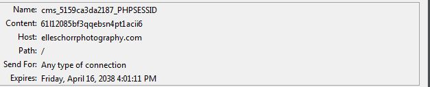

I've attached the page code and the 2 cookies that are generated when a non-Admin user logs in. cms_5159ca3da2187_loginsession and cms_5159ca3da2187_PHPSESSION.
