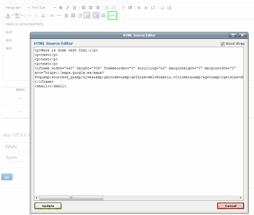

Are you adding this code directly into a WYSIWYG editor? I think the issue might be that the editor is converting the code so that it appears on the page, as opposed to be run by the browser. To get around this, you need to add the html code into the html editor. To do this press the html button on on the second row of buttons in the editor, then add the iframe code where you want it to appear on the page. I've added a screenshot that shows you how to do this. The button highlighted in green will open the html editor window.
