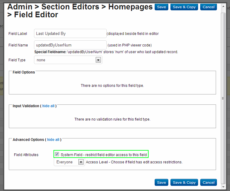

I have a question regarding a different aspect, I set (By mistake) a field as  "System Field"( restrict field editor access to this field). How can this action be undone?
Carlos Pinedo
Hi Carlos,
You can do this fairly easily. While logged into CMS Builder, if you go to section editors area, then click the modify link on the section you need to edit. This will bring you to a page that shows all of the fields in a section. If you click modify on the field that you've accidentally made a system field. This will bring a up a pop up box where you can edit all of the details for the field. At the bottom of the dialog box is area called advanced, which has a checkbox to decide if a field is a system field or not. You edit this for any field except the num field.

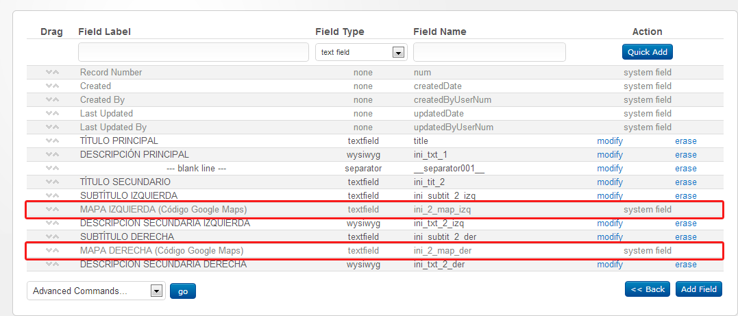

Actually, the problem is that the "modify link" disappeared after I accidentally set those fields as "System" fields. I'm attaching an image of this problem.
Carlos
Thanks a lot Greg! problem solved.
