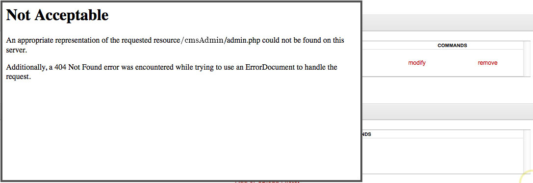

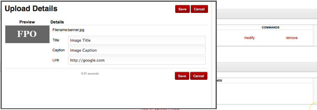

Yea - see they have part of the mod_security issue resolved, but there still remains another issue - whereas if you create an upload field and add a link among the info fields. The "link" on the uploaded image triggers the 406 not allowed message as well. I wasted close to 4 hours of my time discussing these issues with them last week and finally had to threaten to pull all my client's websites off Godaddy servers and find a new hosting provider who actually provides a hosting solution that allows a web developer to build websites that meet the needs of our clients.
The ability to add a link to an uploaded image in an "Upload" field still remains an issue for me as seen in the attached snap shots.

As a matter of fact, that is exactly what caused my error.  I was working with banner images with internal and external links and, if I remember correctly, I could link to an internal page but if I tried to link to an external page with http:// it would give the error.  I guess I got lucky and reached a persistent tech person.  It took almost an hour on the phone to get it resolved.

There still remains an issue - whereas if you create an upload field and add a link among the info fields. The "link" on the uploaded image triggers the "Not Allowed" 404 message. I've spoken to Godaddy repeatedly about this issue and they're telling me it's a CMS issue and not their problem - which I do not believe them, as I have many CMS Builder powered sites (same version 2.61) installed on other servers that are not their new cPanel based servers and CMS Builder works perfectly.
The ability to add a link to an uploaded image in an "Upload" field still remains an issue as seen in the attached snap shots.

Yea - I tried entering the client's domain name with http:// in the URL and it produced the "Not Acceptable" 404 message and when I dropped the http:// form the URL it saved just fine without issue. I also sent them a link to this thread so they can read through and see that I'm not the only one having this issue, but I'm going to send them your demonstration to back this up.

Ok, sounds good.  Here's the outstanding issue and previous message re-posted again so it's clear.  Don't talk about the CMS, that will confuse them, just point out that adding ?address=http:// to ANY url returns a 406 error.  Meaning you can't submit URLs in ANY email form or CMS at all.   Here's my message again:
The issue is that the web host has some security mechanisms in place that attempt to block malicious urls.  The problem is that these security mechanisms are generating "false positives", just like when you get a valid email in your spam filter.
So many URLs that contains "http://" get rejected.  This is a problem because it prevents you from entering the URL of some of your social media sites into your CMS because when those forms get submitted to the CMS via either GET or POST submissions they get blocked for containing a "http://" value that matches a securityfilter even though they are perfectly normal urls.
Adding ?address=http%3A%2F%2F to ANY url on the site demonstrates the problem, here's an example:http://example.com/?address=http%3A%2F%2F
