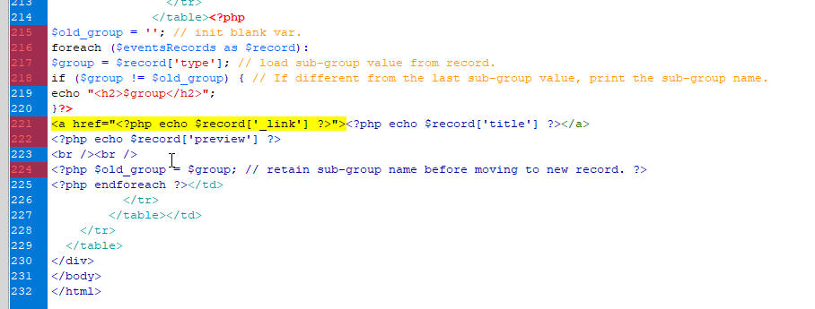

Hi all,
I’ve come up with a weird issue.
Lately, when I copy any php code snippets from my CMSB Cookbook recipe detail page (that is displayed in the latest version of Firefox with standard security settings and no plugins), and try to paste it into a blank php page, I get a multitude of errors (I’m seeing them in Dreamweaver, image attached) and the errors also keep the page from displaying in a browser. A copy of a page with malformed code is also attached.
I can, however, generate clean detail viewer code for the detail page and any code copied from that page viewed in Firefox throws no errors and works correctly.
I can also view the recipe detail page in either Chrome or Edge, and any copied code snippet show no errors.
I'm running CMSB Version 3.57 (discovered the issue in 3.55 before I updated today) and PHP 7.4 (Bluehost hasn't updated my server to PHP8+ yet)
I’m pretty sure that it has something to do with the code on the detail page (attached) that is generating some non printable characters that mess with Firefox, but I’m pretty much at the limit of my expertise here.

Hi Jerry,
That's an interesting one!
It looks like the spaces in the code are being replaced by a multibyte UTF-8 sequence (hex: C2A0, unicode: U+00A0) which is the no-break-space (nbsp) Unicode character.  PHP doesn't understand that as a space, so it's as if there an unknown character anywhere a space should be.
It may be the code formatting PHP code is inserting that.  Or you might have some code that is turning   into that.  In any case, you want to use the HTML entity
I'd double-check any code formatting code you have.
Hope that helps!  Let me know what you find out!

Hi Jerry,
Maybe a small clarification here...the errors are occurring AFTER pasting into dreamweaver, right?  Have you tried opening a plain text editor like notepad, uedit, etc...and compare the result to the dreamweaver paste?  If it works flawlessly in the plainer editors then my guess would be dreamweaver is the issue.
Hi Codee,
Thanks for the insight.
It's so hard to tell.
I switched to Chrome and the code in Dreamweaver was fine.
After a few upgrades of Firefox, the issue seems to have dissapeared also. I'm using a really old version of Dreamweaveer though so maybe it was that after all.
