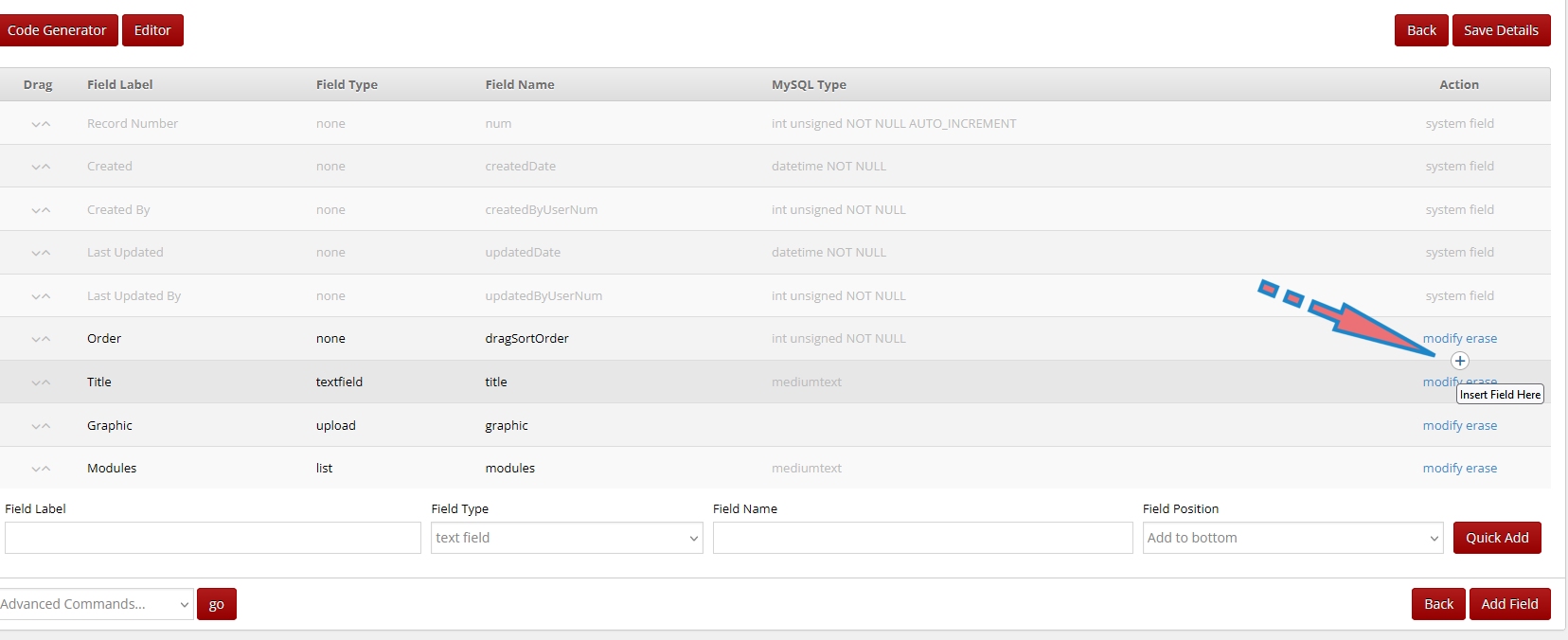

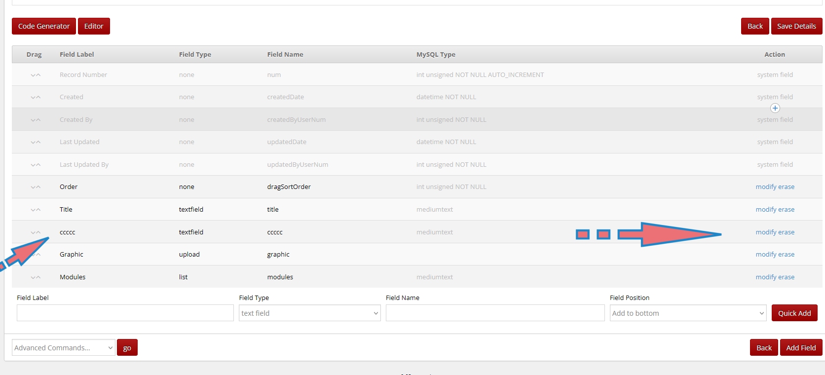

*ON A SIMILAR note, concerning the "insert field here" function within the database editor...the function is inserting the field lower than the chosen point, and thus has to be manually dragged to the correct location.  I have attached a couple screen shots from within the database editor on a table - shot 1 is before and shot 2 is after. It's consistent across the board with different tables, etc.
