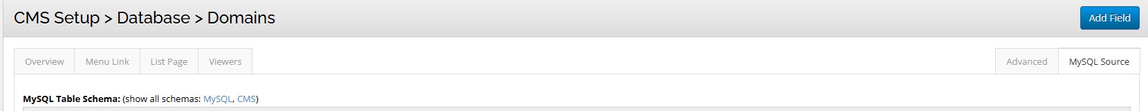

  1. When I go to CMS Setup >Database> *Database Table* the last two tabs (Advanced and MySQL Source) are aligned to the right and separated from the first three tabs. Is this intentional?
Yes, this is intentional, although I know split tabs are a less common pattern. The thought is to visually separate the everyday settings from more technical options that most users can safely ignore. The primary tabs (Overview, Menu Link, List Page, Viewers) are grouped on the left, where users naturally start, while Advanced and MySQL Source are available but visually de-emphasized on the right. This helps reduce cognitive load for typical users while keeping power-user features accessible when needed. The "Advanced" tab label already signals the nature of those tabs, but we're always open to feedback - if the separation feels confusing or causes friction in practice, let us know and we can revisit it in a future update.
It took a little bit to get used to, but I've been using it for a while and find it simpler and faster. Those menus may continue to evolve as we add new features that need configuration options.
