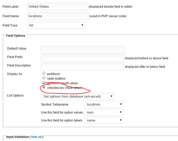

For the check boxes, I'm using them as you use a dropdown in your screenshot, in the advanced list options (multi value). Unfortunately, the default checked option doesn't appear to be there.

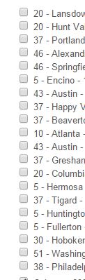

For the checkboxes, like the list that appears for an admin in the screenshot I previously posted  with the multiple "Austin" locations, I want all those checkboxes pre-checked. Imagine one table for locations, another for promos. The idea being that when creating a new record for a promotion, the admin can select which locations are running that promotion. Most of the time, it will be all of them. Sometimes, one or two may opt out. In order for an admin to allow a location to opt out, i figured there needed to be checkboxes. Having to select all the locations with individual checkboxes seems ridiculous after pressing "create" to create a new promotion. It would make more sense in this situation to load them all pre-checked for an admin. Sometimes the admin will have to uncheck one if a location is opting out of the promo.
In another table, there is a situation where most would need to be unchecked.
Maybe for the promos i should just make the checkboxes "checked = opt out". I was just hoping to keep it consistent with the rest of the site where you check a box if a location is included.
i have attached another screenshot to show where i am using checkboxes in these lists. As another example, think of how you are showing me a screenshot using a dropdown as opposed to checkboxes. What if you were using a multi value dropdown and knew that 9 times out of 10, the same multi selections would be made? You may want to pre-select them. Especially if you are talking about 100 locations.

By rez - March 24, 2015 - edited: March 25, 2015
How would I show the state if that's in another editor as an advanced list (another table)?  Unfortunately, it displays as a number. Much like on a page where you would have to use state:label.
SELECT num, CONCAT(state,' - ',city, ' - ',address)
  FROM `<?php echo $TABLE_PREFIX ?>locations`
Something to do with JOIN?
screenshot attached.
