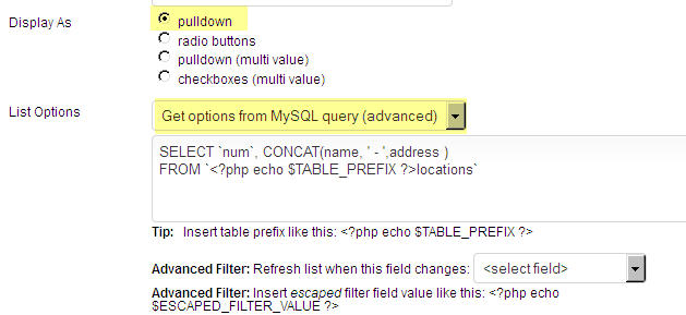

First, you need to change the location lookup field List Options to Get Options fro MySQL query (advanced)  Then enter the following in the query. (I am assuming that the table and field names match your database)
SELECT num, CONCAT(name, ' - ',address)
  FROM `<?php echo $TABLE_PREFIX ?>locations`
This will concatenate the name, a spaced hyphen and the address in the lookup dropdown list.  I attached a screenshot.
As for default check boxes ... very simple .. set default to checked.  See attached screenshot.
Hope this helps!
