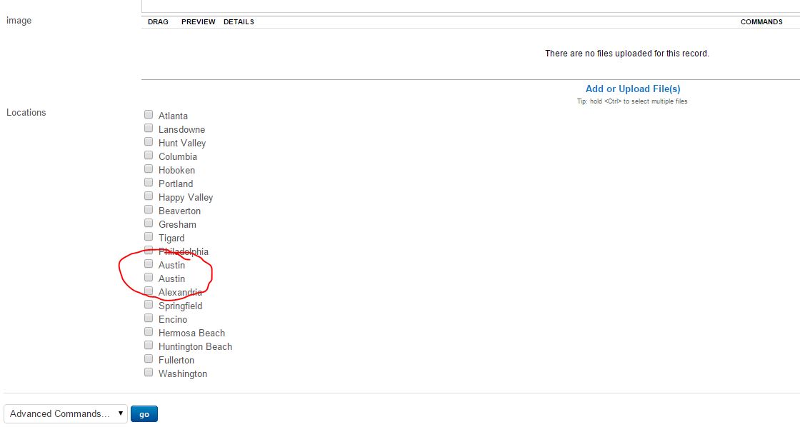

I'm using a list in an editor, pulling from a table of store locations. I am using checkboxes with num as the value and city as the label. However, there are multiple locations / addresses in each city. So when viewing these checkboxes as an admin, it would be helpful to see the city and the address.
i don't know if this is possible with the "get options from MySQL query (advanced)" or if that has nothing to do with display.
I hope that's clear. I attached a screenshot of the problem. Something like the following would be helpful. I guess i could make a 3rd, redundant  label in my store locations table but thought there must be a better way.
_ Austin,  123 West Canyon Ridge Drive
_ Austin,  456 S. Lamar Blvd
Thanks for any help.
Capture-IT.JPG 45K

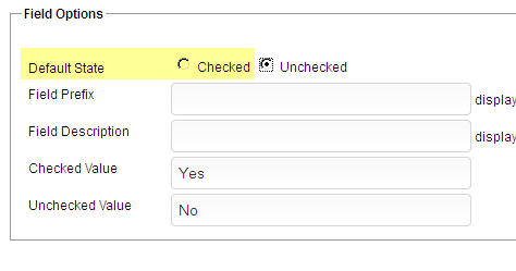

As for default check boxes ... very simple .. set default to checked.  See attached screenshot.
Hope this helps!

For the check boxes, I'm using them as you use a dropdown in your screenshot, in the advanced list options (multi value). Unfortunately, the default checked option doesn't appear to be there.
